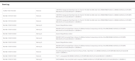

Here is what I have for my error logs. I have been having issues with Cox Internet where the Wifi cycles off for a few moments then reboots. Cabled connections don't seem to have the same issue.

Events logs show a line issue. You need to have the ISP review and resolve any Errors, Criticals and Warnings.
Have the ISP check the signal and line quality UP to the modem. Be sure the ISP provisions the modem correctly.

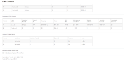

Here's the Cable Connection Status
I'll discuss with the ISP. The weird thing is that I work remotely all day with a cabled connection with no issue or interruption of service, even if the Wifi goes down. It's only the wireless internet that cuts in and out.- FURRYe38Mar 21, 2023Guru - Experienced User
Need to see the full cable connection status page. Scroll down to reveal the rest of the page.

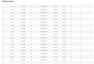

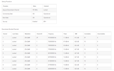

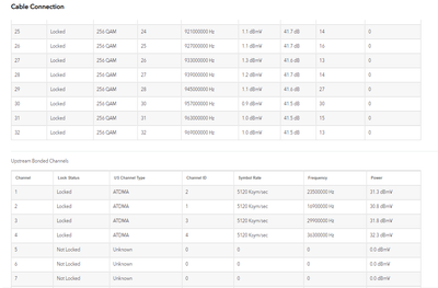

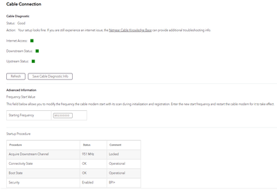

Sorry about that. Here you go:
