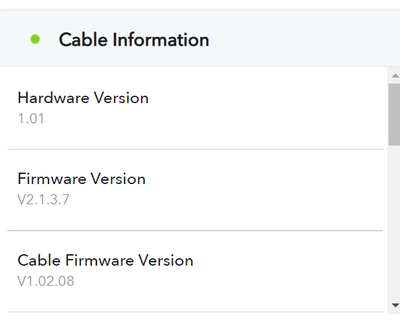

Getting similar issue. I noticed on 11 Jun 22 the Downstream light was flashing. I unplugged power for 30 seconds and plugged back in which resolved the blinking light. Then on 12 Jun 22, approx. 0300 MST, the modem rebooted and it has rebooted every day since about that time. I reached out to Xfinity, who after much nashing and wailing for teeth, they said that there was a downstream issue and that I needed to switch to a different outlet . . . Still scratching my head over that one. Been plugged into the same one for 2 years, no issue.
SO here is what I see on my Modem page:
Any ideas? I don't think switching outlets will have any result, not sure what the downstream, coming through the Coax, has anything to do with being plugged into the power outlet.

Ok, downgraded to .5
However, how do we prevent .7 from being reinstalled? I did NOT update to .7, router did it automatically. I've searched through the settings and I do not see any option to NOT update.

*sigh* nope, reset again, but was 2 hours later than normal, at 5am instead of 3am.
BUT I'M BACK TO .7
