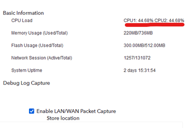

- FURRYe38Jun 21, 2022Guru - Experienced User
I would be concerned about the CPU usage being that high. Wow.
Are you seeing this all the time on the modem?

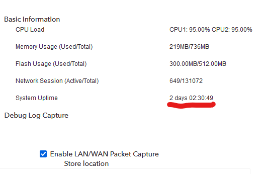

- tamanacoJun 21, 2022Apprentice
FURRYe38... No, my CPU utilization is normally not that high. That screenshot was probably taken when my two NASes were syncing the previous day data. This usually happens overnight after 1am, but because of the router reboots I had to recently rescheduled the sync to 7am.

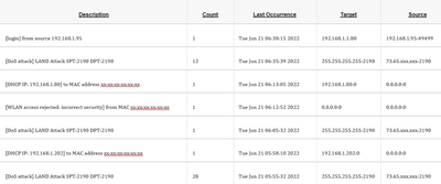

Now then, with regards to the DoS Land Attacks. When I log into my CAX80, the logs show:
The 192.168 addresses are called NAT, see description above. THESE are provided by the Router side, these are how Home Routers are typically setup, but they can be changed to anything. If you are curious to know more, you need to look up NAT or IP Address convections to learn more. As for the others that show 73.65., this is the starting address assigned to Xfinity by the Global IP Address commission. And when I look at the Modem IP Address it is the same as the Source under the DoS Land Attack. IF you see the same then it is coming from WITHIN, if this is showing different then chances are it is coming from outside. You can use any IP Address lookup tool to see the Source address and who it is assigned to.
- FURRYe38Jun 22, 2022Guru - Experienced User
So I see, these are coming suppossedly from the WAN side. Target is 255.255.255.255 oddly.
