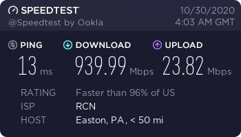

CyborgMonkey What kinda max speeds is the router getting?
- CyborgMonkeyOct 29, 2020Guide
jesmith602 I'm able to get the full "gigabit" speed that RCN offers, 940/20:
FURRYe38 Yeah maybe this is the case that it needed some time to readjust. When the device entered the failure mode before it was always the MDD timeout message that was the last event I saw and it's timestamp was always just about spot on with when the downstream unlock would occur. It's good to see now that while these messages are still there (maybe they're common as it's only classified as a warning?), at least they aren't triggering the failure mode anymore. Anyways, will see how it goes!
