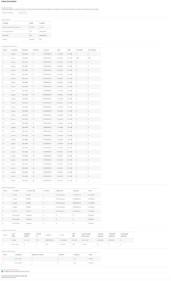

CAX80 Speed Issues
I am unable to get my CAX80 faster than 200 down on a wired or wireless connection. I have Cox Gigablast No splitters, amplifiers, or attenuators in line. Using RG6. CAX80 is in router mode. Th...
