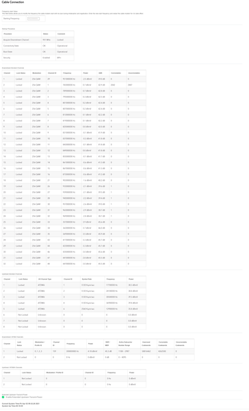

CAX80 Speed Issues
I am unable to get my CAX80 faster than 200 down on a wired or wireless connection. I have Cox Gigablast No splitters, amplifiers, or attenuators in line. Using RG6. CAX80 is in router mode. Th...

- FURRYe38Apr 02, 2021Guru - Experienced User
Is Armor enabled by chance?
Anything running on the PCs what could slow down speed tests?
Try a factory reset and setup from scratch then run a speed test again?
