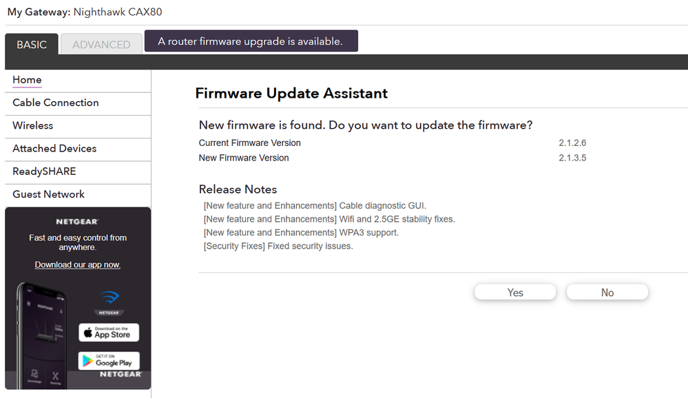

CAX80 Updated to Firmware 2.1.3.5

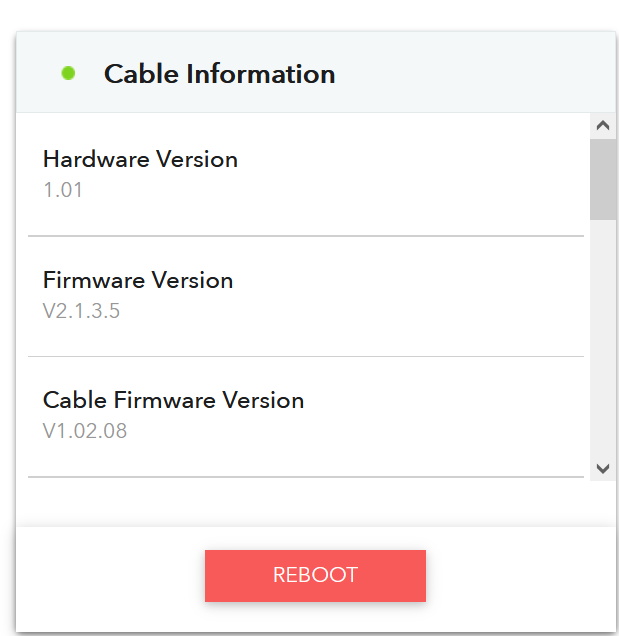

This morning I was presented with Firmware Update 2.1.3.5 for my Netgear CAX80. After thinking it over for a couple minutes I took the plunge and installed it. The Firmware Update installed fine, but I had to power cycle the router to get up and running. So far, it appears that I didn't loose any of my router configuration setting, but I had to add my admin password when I re-stablished connection to the router and re-add my security questions.As expected, the Modem Firmware remained at the same level. The Release Notes details are on a screenshots below.  Let's see how it goes.

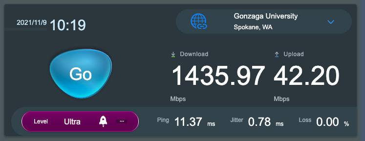

  • I appear to have an issue with this firmware consistently reporting my cable connection as "Poor" even though I'm getting full upstream bandwidth (41+ Mbps of a theoretical 40 Mbps max). The coax run to the box is about two feet, no splitters.
