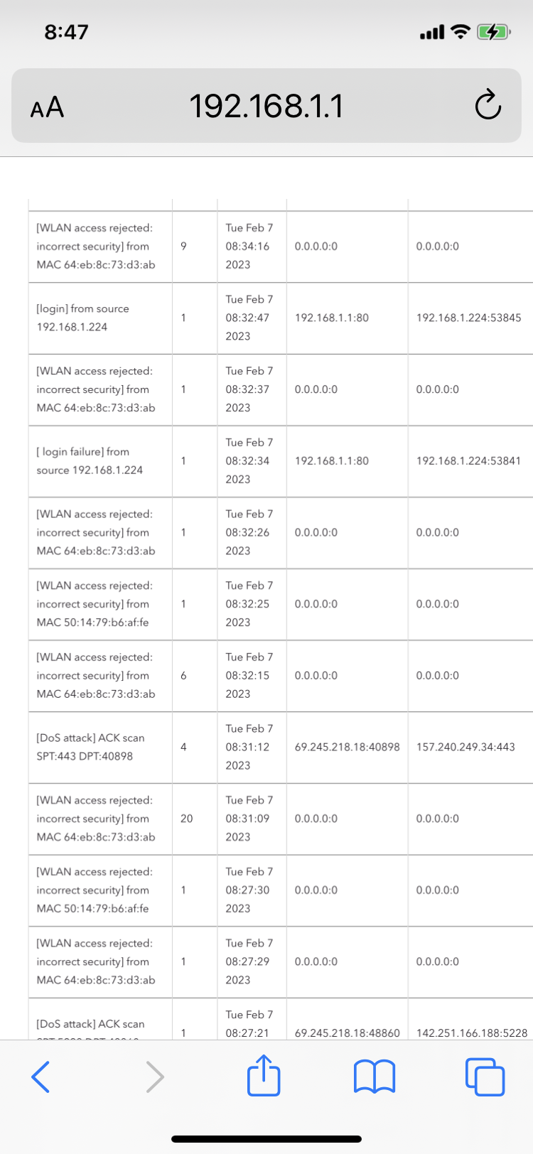

- titanicnutFeb 07, 2023Star
- FURRYe38Feb 07, 2023Guru - Experienced User
Need the full page bottom portion of the cable connections page please.
I see some wifi issues on the event logs page. One of your devices keeps trying to connect with incorrect security. Be sure all of your devices are connecting correctly to the modems wifi. What is the device with the mac address of d3:ab?
- titanicnutFeb 07, 2023StarI saw that too. I’ve gone to every device in the house and checked to make sure it’s connected. They all are so I have no idea what that device is that is having connection issues 🤦🏼
