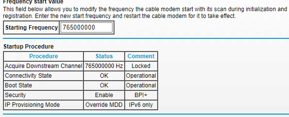

- SMASHMASTRNov 16, 2021Tutor
So this is what I was able to gather after following the steps you gave me (thanks btw).
Is there something that I would have to change with the starting frequency?
