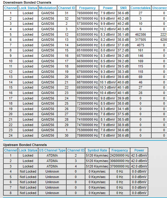

I have had the CM600 for about 3-4 months. I bought the product so as to stop renting Spectrum's Modem & Router. It runs well, however after a week of running, it stops working and I have to power of...

Checking your cable connections picture I saw, the modem is seeing lots of correctables and un-correctables. The ISP needs to look into this. There should be near zero seen here.
Have the ISP check the signal and line quality UP to the modem. Be sure the ISP provisions the modem correctly.
Be sure there are no coax cable line splitters in the between the modem and ISP service box.
Be sure your using good quality RG6 coax cable up to the modem.
Be sure to power OFF the modem for 1 minute then back ON.

Nov 16, 2021Tutor
So this is what I was able to gather after following the steps you gave me (thanks btw).
Is there something that I would have to change with the starting frequency?

Yes, from the cable connections table (that I was supposed to upload but instead uploaded the wrong snippet, and am not home to upload again) there are 2 frequency channels that I remember seeing HUGE numbers under correctibles and un-correctibels as you mentioned. I will contact my ISP in regards to provisioning the modem more carefully, and maybe have them come and replace the RJ6 cable that my house has (as when I moved into my house, the previous people had it set up from Dish Network if I remember Correctly). I will be coming back (hopefully within a week) to give everyone here a status update on my modem. Thank you guys so much. You have all been of great help to me.
- SMASHMASTRNov 16, 2021Tutor
Ok, so it seems that by un-hooking the splitter that the previous technician had used seemed to have mitigated the correctables and such on a HUGE level. Like to the point I no longer have uncorrectables. But my ISP did say that if my original problem still persists, that they can send out a tech worker to inspect everything and maybe even switch out the RJ6 cable for one of their standard ones. So, I would like to thank you guys so much for helping me out with this issue that has been pestering me for the longest now. I'm glad to know that there are pros like you guys that can help people out when they are in need of guidance.
