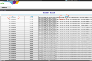

CM1000 dropping connection issue
Hi, I'm having a connection drops randomly through out the day. My ISP is Optimum and they have a really bad service but unfortunately, because of the location I can only have their service. I remov...

Please post a copy and paste of the modems connection status page.
https://kb.netgear.com/30007/How-do-I-obtain-the-cable-connection-information-from-a-NETGEAR-cable-modem-modem-router
