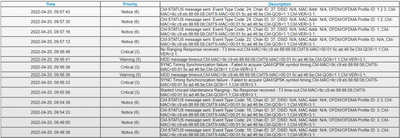

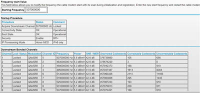

Got a screen snip of the cable connections page and event logs?
that helps us to check the connection.
If that looks good, then I'd be investigating the router setup.

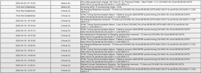

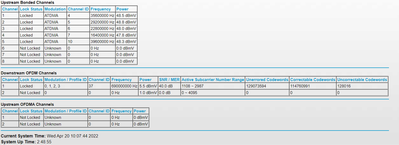

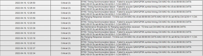

You've got errors in the line and in the logs. I don't think its necessarily whats causing it but they are there.
Start with removing any amplifiers, signal attenuators, or splitters from the coax.
From there check the line for kinks, damage, moisture in the line.
Check the connectors for improperly made ends, foil touching the copper coax line, bad/old/cheap connectors, or corroded connections. Replace them if you have any issues or suspect cables/ends.
If you can, simply connect the modem right where the coax comes into the home. This prevents wiring in the home from being the issue. And some ISP’s charge if the wiring issue is in the home. So this helps prevent this.Try that. I'd also try a different pc/laptop to see if it is indeed a computer issue
