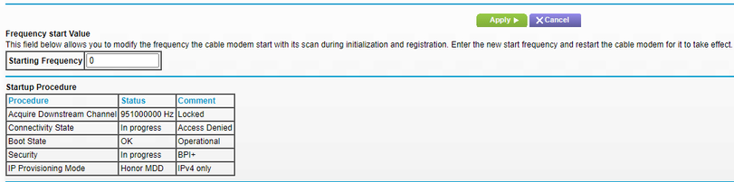

CM1000v2 connectivity state access denied

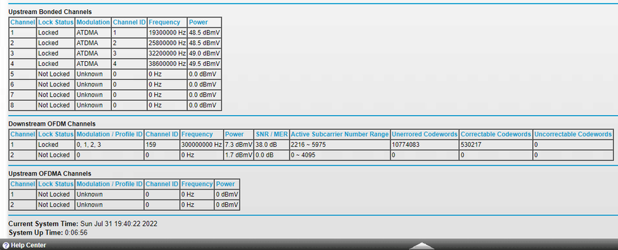

My internet went down this morning so I went through some basics first, power cycles, reseating cables, soft resets and cmd line resets. I took my nighthawk router out of the line and directly connec...

It does look like my upstream is having a major power issue. Everything I am reading is that this should less than 37 dBmV. if this is my main concern what should I do about this because swapping modems likely would not resolve a power issue on the line. This has been running solidly for well over a year at this point so odd to see a power issue like this imo.

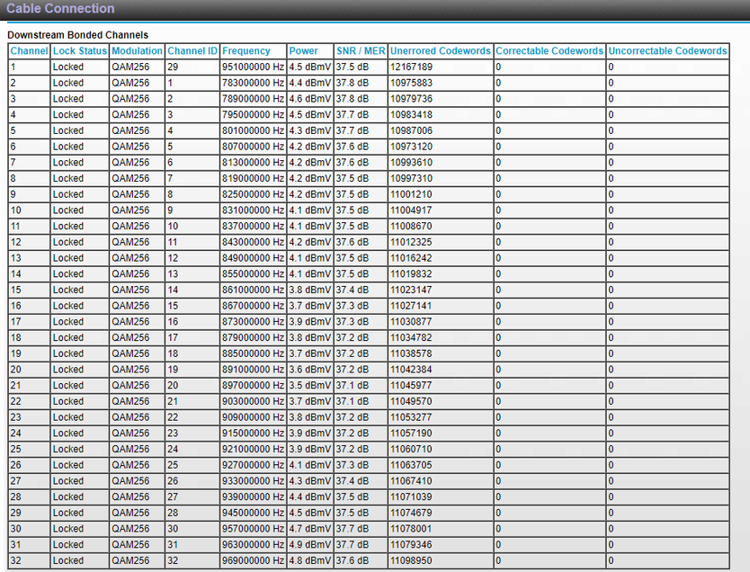

Please post a copy and paste of the modems connection status page.

- CinnaderpJul 31, 2022AspirantI have linked the modem connection page already. Cox isn't getting communication to my modem so I had them re-provision the device. The modem is stating online with downstream/upstream solid and green so some form of communication is going to cox. I replaced the coax cables in use with no change. There is a convertor in my attic that is the only tossup as it just has an on light and may be the root cause of this whole disconnect.

Please post the download and upload cable connection status page in it's entirity please.
I would by pass the converter and directly connect the modem to the ISP coax line that comes into the home and see if this changes anything.

the full capture message is not sticking for some reason.
