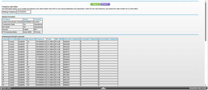

CM1000v2 extremely slow upload speeds
Swtiched from a Comcast XB8 gateway that was not staying in "bridge" mode to my own CM1000v2. I'm getting the expected 750mbps download on a 1gig plan, but the uploads are crazy slow (5-6mbps). I've ...
Mar 21, 2025Guru - Experienced User
Well power levels are are the low side but with in specs:
https://kb.netgear.com/24311/Power-level-guidelines-for-a-NETGEAR-cable-modem-router
Correctables and Un-correctables are good.
Please post the Event Log data from that page.
Be sure your using a good quality LAN cable between the modem and router. CAT6 is recommended.
What is the brand and model of the host wifi router connected to the modem?
