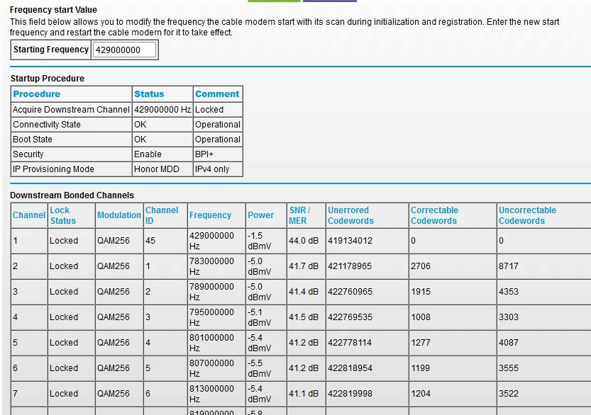

Thank you so much for your reply. Apparently I have lots to learn about this forum. Unfortunately, my reply isn't showing up like the original post doesn't show. I copy/pasted from the 1st post. I'm going the image route this time. Please let me know if I need to add additional information. Once again, thank you very much!!!!

You've got a lot of errors in your line and your power is way out of spec.
Start with removing any amplifiers, signal attenuators, or splitters from the coax.
From there check the line for kinks, damage, moisture in the line.
Check the connectors for improperly made ends, foil touching the copper coax line, loose connections, bad/old/cheap connectors, or corroded connections. Replace them if you do.
If you can, simply connect the modem right where the coax comes into the home. This prevents wiring in the home from being the issue. And some ISP’s charge if the wiring issue is in the home. So this helps prevent this.After you do all that, post your results back here. If they haven't changed, the ISP needs to check the line.

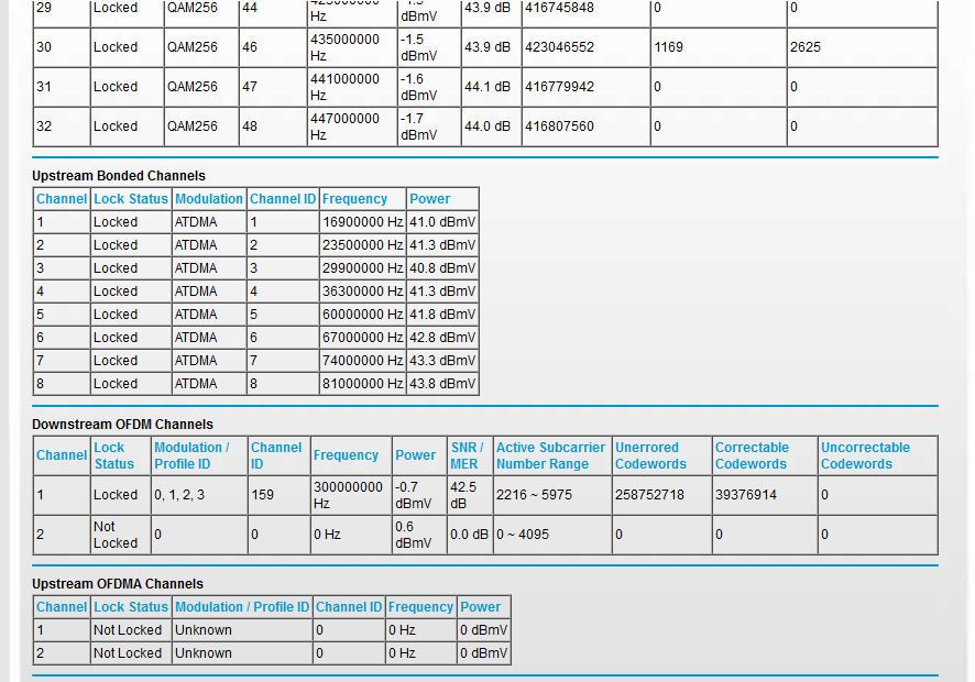

I had already taken the steps from your checklist. I called Cox and scheduled an appointment for a tech. He came out today and worked in the alley and on their box on the house.
He assured me he'd fixed the issue. He was great to work with. Probably my best experience with Cox in 20 years.
Do the numbers reflect his work?
I really appreciated your help.
