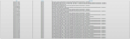

CM1000v2 Slow Upload Speeds
Just installed a CM1000v2 in place of the rented xfinity modem/router, activated it, and hooked it up to my PC with a CAT8 ethernet cable. The speeds I'm getting are 700 down/5 up. My plan is 1000 do...

igorr wrote:Just installed a CM1000v2 in place of the rented xfinity modem/router, activated it, and hooked it up to my PC with a CAT8 ethernet cable. The speeds I'm getting are 700 down/5 up. My plan is 1000 down/200 up. What could be causing the 5Mbps upload speed over gigabit ethernet? Cable connection and log screenshots attached.
Your CM1000v2 is not on the Xfinity list of certified modems for connection to their Next Generation Speed network.
That means you do not have access to the 100/200 Mbps upload like you had through your rented gateway.

Any Criticals, Errors or Warnings seen in the event logs needs to be reviewed and resolved by the ISP. Indicates a signal issue on the ISP line up to the modem.
