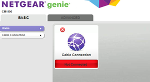

Out of the blue most of my devices (all laptops, phones and ipads) cannot connect to my wireless network. I have Access Control configured and it is blocking them. My security cameras are still con...
- Aug 15, 2022
The CM series of modems does NOT have wifi or built in router.
Odd to see wifi and parental controls on this page in the bottom picture. The first two pictures are correct and should be all that is seen for the CM1100 modem.
Do you have a external router connected to the CM modem? Brand and model please.
Be sure you clear out all browser caches before entering the modems web page.
