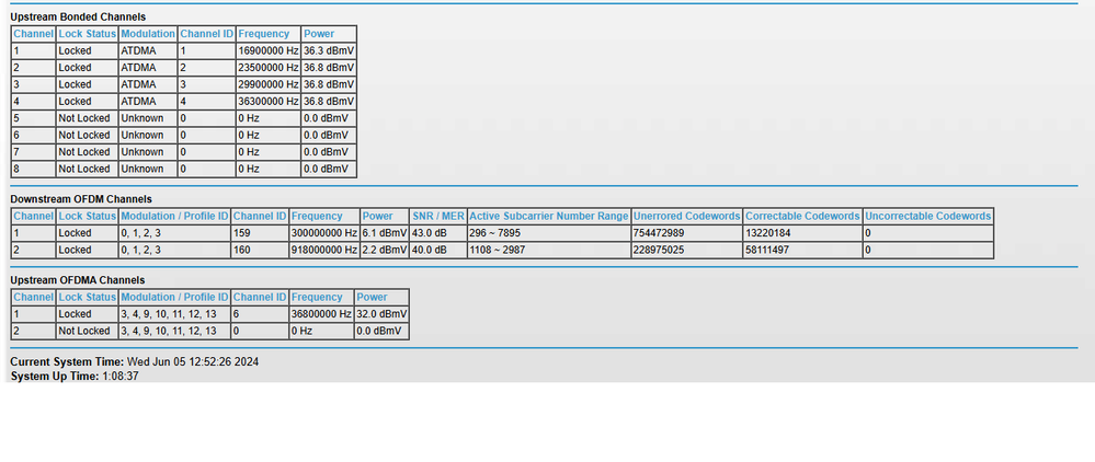

CM1100 need to reset modem constantly with COX
Hi all, used to be every few days but now I am having to reset the modem multiple times a day and it is driving me nuts. Here is the connection after a factory reset. Many thanks! Startup P...
- Jun 06, 2024
Looks good. Some channels are a bit far in power between the channels however if it's working. Let it run.

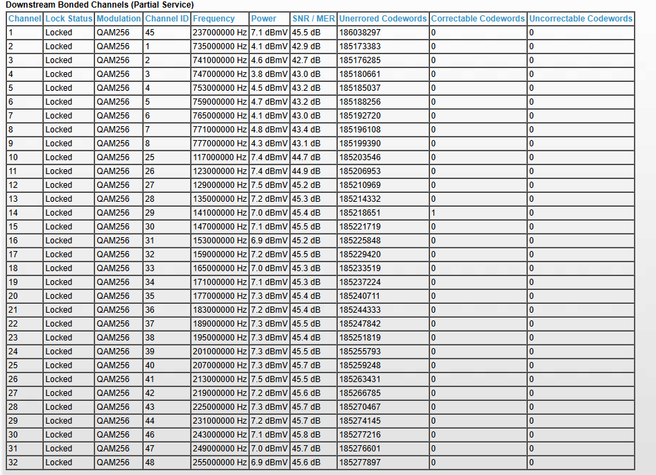

Hi all, I am back with another set of connection status. This is from yet another new outside line, put in by Cox today (first time, AT&T cut my line while putting down fiber cable on 5/23). This is without any attenuator (I do have a 6db and a 3db). Should I give the 6db attenuator a try to bring down the power level? Thanks...
- FURRYe38Jun 05, 2024Guru - Experienced User
Yes.
Good on the correctables and un-correctables.Hows the event log look?
- Larry2024Jun 05, 2024Guide
Only Notice, there is no warning or critical...
- Larry2024Jun 06, 2024Guide
Up for 19 hours and all the channels with above 7 dBmv started to accumulate correctables and un-correctables, with notice events only. I just added the 3db attenuator and will let it run for a day to see if it is any better. If not I will put the 6db on. This is the connection status with the 3db. Thanks!
- FURRYe38Jun 06, 2024Guru - Experienced User
