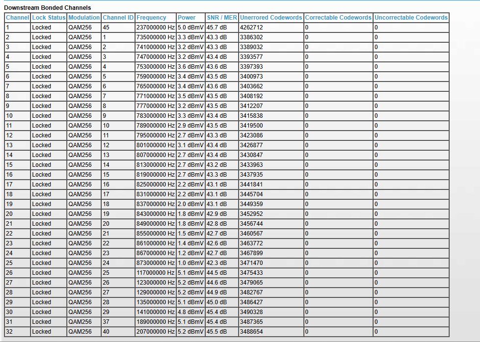

CM1100 need to reset modem constantly with COX
Hi all, used to be every few days but now I am having to reset the modem multiple times a day and it is driving me nuts. Here is the connection after a factory reset. Many thanks! Startup P...

Looks good. Some channels are a bit far in power between the channels however if it's working. Let it run.

Up for 19 hours and all the channels with above 7 dBmv started to accumulate correctables and un-correctables, with notice events only. I just added the 3db attenuator and will let it run for a day to see if it is any better. If not I will put the 6db on. This is the connection status with the 3db. Thanks!
Jun 06, 2024Guru - Experienced User
