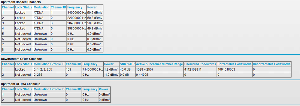

Do you actually have a screen snip of the modem's cable connection page and logs? It wouldn't be the first time a tech has said the signal is fine when it wasn't.
- The_VWJun 12, 2021Tutor
yep, here you go.
