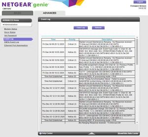

CM1150v extremely unstable critical(3) - Started Unicast Maintenance Ranging and SYNC timing errors
Team, I have a xfinity 600Mbps plan. The Cable modem I have is CM1150v. I have hooked one Netgear wifi-router via ethernet connection from the CM1150v<-->NetgearR6700. Over the last 2 weeks, our i...
