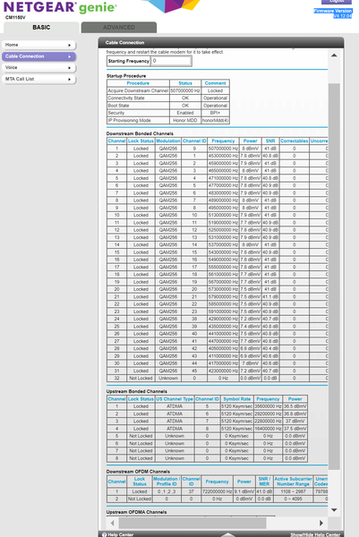

CM1150V Slow download with xfinity
Firmware Version V4.12.04 Our service is 1200 down and we typically get about 950 down, but I don't have a network card that can do higher. Saturday our download speeds dropped to about 95 and e...
