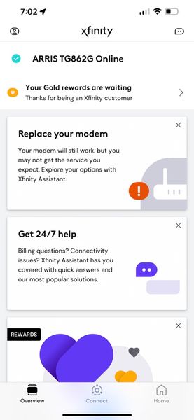

CM1200 activated as ARRIS TG862G via Xfinity app
After replacing my CM1200 last December due to constant connection issues with Comcast, I wanted to try it out again to see if Comcast made any changes on their end or if mine is defective. But a...
plemans
Apr 30, 2022Guru - Experienced User
Its just going to be how comcast identifies it in their system. It shouldn't change performance at all.
I wouldn't worry about it.
In terms of your upstream channels, thats not an issue either. Reason why is upstream is so much lower than downstream. I'm on the same plan and my upstream speed is 50mbps. 4 channels have no problem saturating 50mbps upload. I've had my modems have 4-6 locked depending on the day. Some days its 4, others its 6.
But its always been able to max out the 50mbps.
