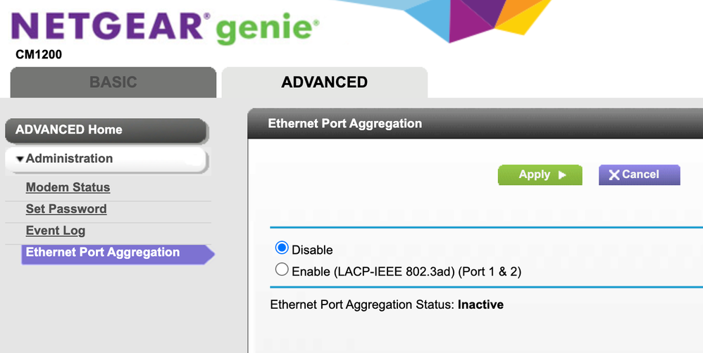

Is LAG enabled on the modem? Link Aggregation

I cannot find where LAG shows on Netgear page. i attached more info from Admin Netgear Modem page
- Julia37Mar 21, 2021Aspirant
Disable
Enable (LACP-IEEE 802.3ad) (Port 1 & 2)
Ethernet Port Aggregation Status: Inactive - FURRYe38Mar 21, 2021Guru - Experienced User
Lag is here:
