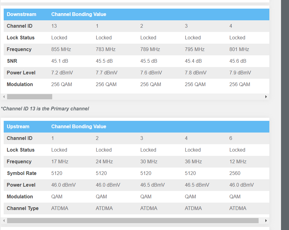

 I have the same issue with the blinking downstream light only.  I have internet, but the downstream light is very annoying and want to avoid anymore disconnects.  I got a 2nd internet line installed ...

Power levels are a bit too high:
https://kb.netgear.com/24311/Power-level-guidelines-for-a-NETGEAR-cable-modem-router
Might ask the ISP to put in a attenuator or a 3db splitter.
Any Criticals, Errors or Warnings seen in the event logs needs to be reviewed and resolved by the ISP. Indicates a signal issue on the ISP line up to the modem.

Is it at all possible that Netgear modem is causing my high power levels? So I called my ISP (Cox) and requested a tech to come out and check the wiring from the box to my house and inform them to install an attenuator or 3db splitter tomorrow. In the mean time I went and installed their Panoramic WiFi Router/Modem to do some testing and so far for about 4 hours, it's consistently staying online with no issues and no downstream blinking lights and I am getting about 880mb download and 40mb upload. I currently have their 1g plan. I guess since its their equipment it has to work, smh. But my end game is to use my own modem because I refuse to pay $5/month to rent theirs.
- FURRYe38Oct 19, 2023Guru - Experienced UserNo. Power comes from the ISP side on the coax.
