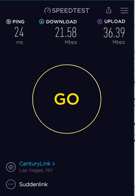

enciberpangel
Apr 11, 2022Aspirant
Here's the cable connection page and a screenshot of a speedtest... should be 1gb .. not even gettign 25Mbps right now
