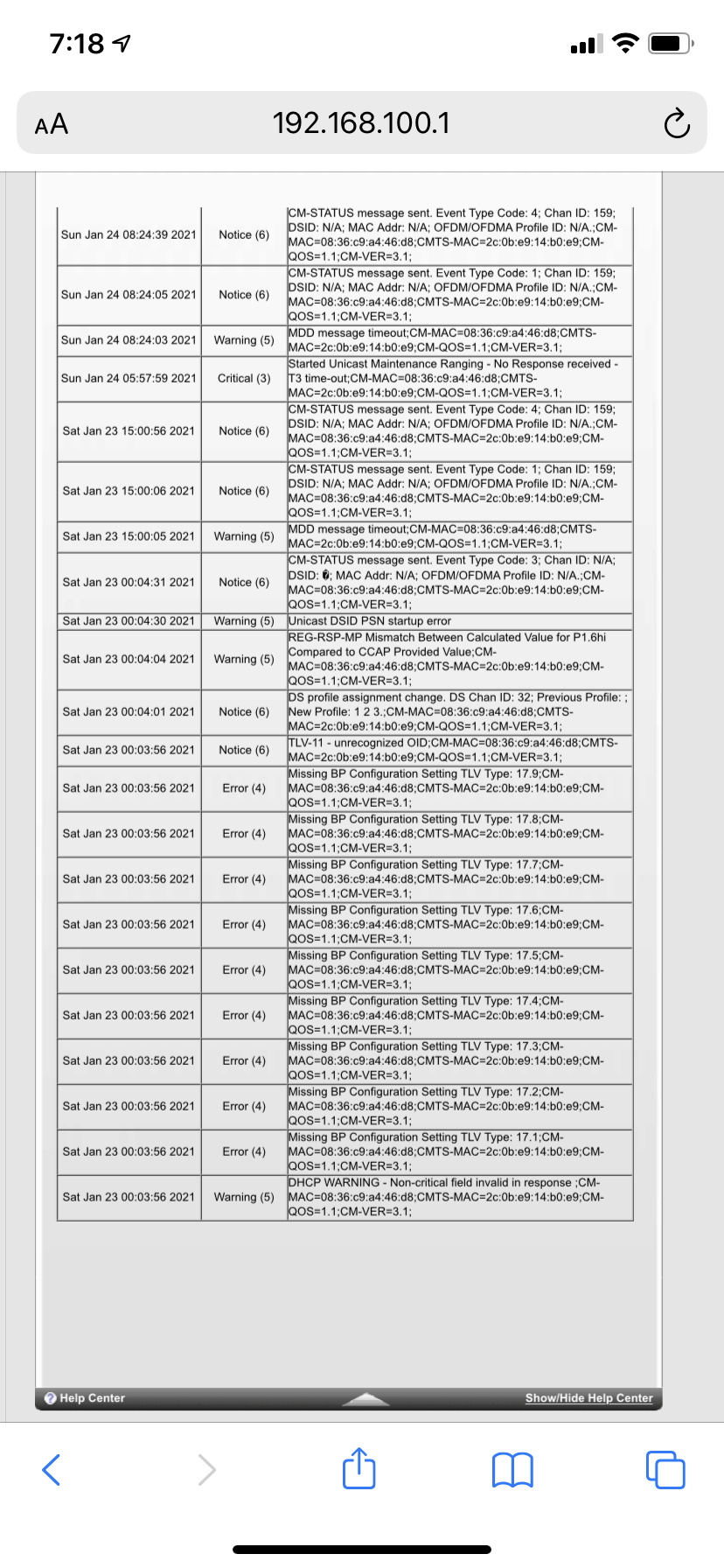

First I appreciate the help and responses. Still trying to narrow down this issue as I await RCN’s technical team to look into this. So this morning at 6:58am the modem dropped service again. Do the attached Event Logs lead anyone to a possible issue? This techy modem jargon is just Greek to me.
bcooper27
Jan 24, 2021Star
2nd attachment.
- FURRYe38Jan 24, 2021Guru - Experienced User
Lots of Errors in there. Thats needs to be reviewed and addressed by the ISP/Tech. Have them look at this log and your connection status page. It should be similar to mine:
