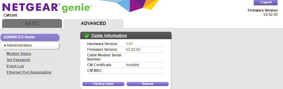

If you can post the same screen capture of your CM1200s web page that I did with mine, Edit out the MAC and CM serial numbers first then post.

Just checked mine:
Seems to appear on this version lastly used. MS Edge browser.
