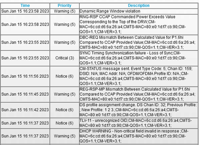

I'm still experiencing issues with my modem's speeds.
I should also note that my Netgear Nighthawk app's speed test output a speed of over 800Mbps for the WiFi, even though Ookla only showed about 230-250 Mbps.
This is an updated screenshot of my event log. Anything else I can try? Would you recommend a factory reset
