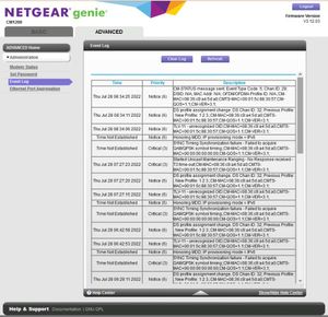

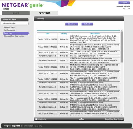

Hey! I run my home network on a Netgear CM1200 Cable Modem/1200 Nighthawk set-up, with Comcast Xfinity as my IP Provider. Lately, our connection has started dropping, just occasionally but enough to...

You have some criticals that the ISP should help you look into.
