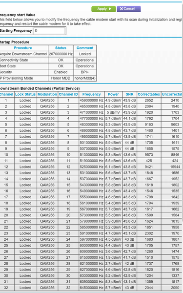

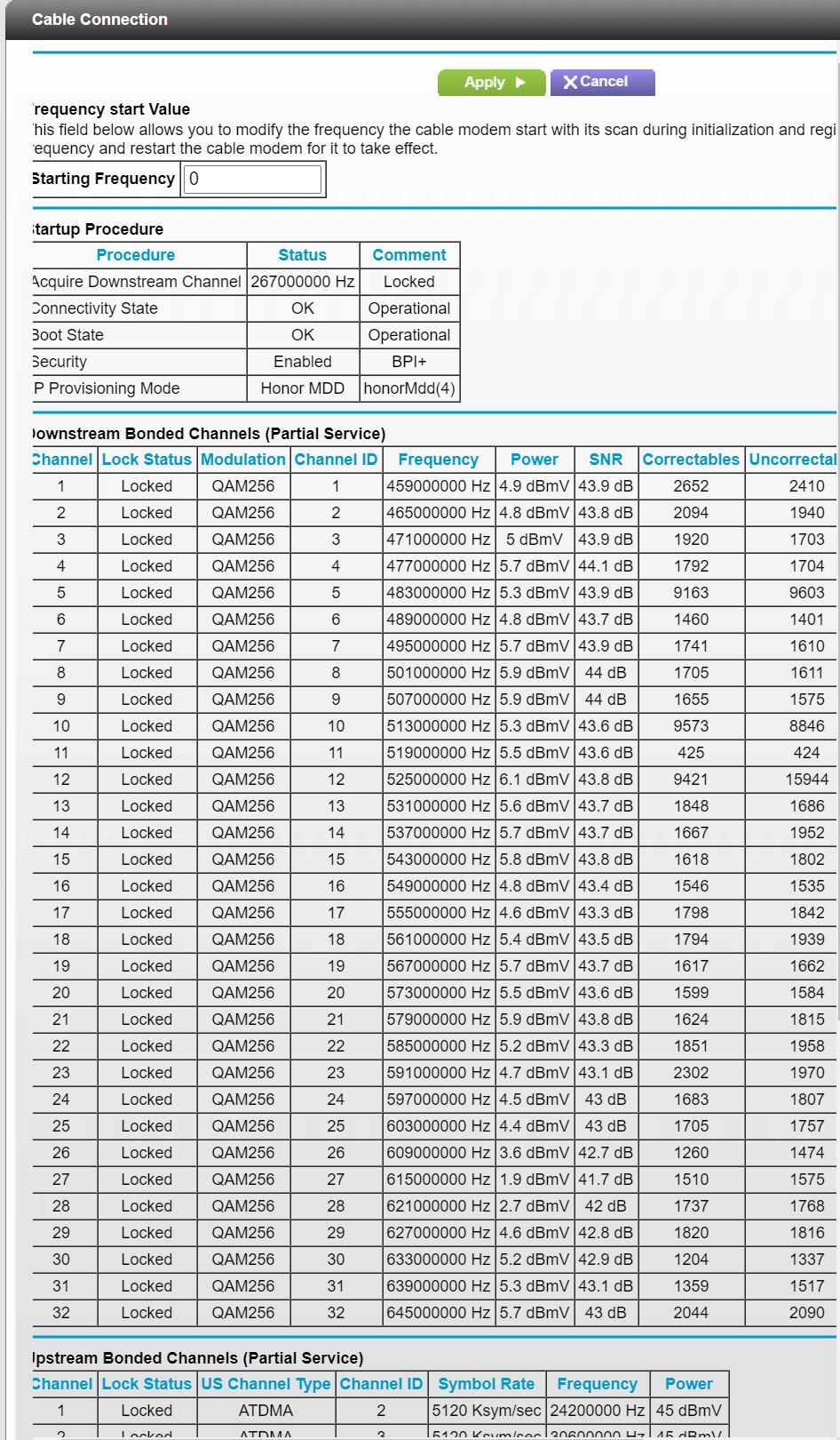

Had a second follow up visit on the issue and the Spectrum techs said everything looked fine from their end and saw no router failures, even when there were drops this morning before they got here. I can't determine what's going wrong or where. Here are the event logs if anyone can help me understand what I'm seeing. Tech took a look and said "I can't do anything with your personal equipment".
Wed Mar 24 10:13:44 2021 Critical (3) Unicast Maintenance Ranging attempted - No response - Retries exhausted;CM-MAC=08:36:c9:40:c3:d0;CMTS-MAC=00:17:10:86:bd:cb;CM-QOS=1.1;CM-VER=3.1; Wed Mar 24 10:13:44 2021 Critical (3) Started Unicast Maintenance Ranging - No Response received - T3 time-out;CM-MAC=08:36:c9:40:c3:d0;CMTS-MAC=00:17:10:86:bd:cb;CM-QOS=1.1;CM-VER=3.1; Wed Mar 24 10:13:43 2021 Warning (5) Dynamic Range Window violation Wed Mar 24 10:13:43 2021 Warning (5) RNG-RSP CCAP Commanded Power in Excess of 6 dB Below the Value Corresponding to the Top of the DRW;CM-MAC=08:36:c9:40:c3:d0;CMTS-MAC=00:17:10:86:bd:cb;CM-QOS=1.1;CM-VER=3.1; Wed Mar 24 10:13:43 2021 Critical (3) Started Unicast Maintenance Ranging - No Response received - T3 time-out;CM-MAC=08:36:c9:40:c3:d0;CMTS-MAC=00:17:10:86:bd:cb;CM-QOS=1.1;CM-VER=3.1; Wed Mar 24 10:13:37 2021 Warning (5) Dynamic Range Window violation Wed Mar 24 10:13:37 2021 Warning (5) RNG-RSP CCAP Commanded Power in Excess of 6 dB Below the Value Corresponding to the Top of the DRW;CM-MAC=08:36:c9:40:c3:d0;CMTS-MAC=00:17:10:86:bd:cb;CM-QOS=1.1;CM-VER=3.1; Wed Mar 24 10:13:37 2021 Warning (5) Dynamic Range Window violation Wed Mar 24 10:13:37 2021 Warning (5) RNG-RSP CCAP Commanded Power in Excess of 6 dB Below the Value Corresponding to the Top of the DRW;CM-MAC=08:36:c9:40:c3:d0;CMTS-MAC=00:17:10:86:bd:cb;CM-QOS=1.1;CM-VER=3.1; Wed Mar 24 10:13:37 2021 Critical (3) Started Unicast Maintenance Ranging - No Response received - T3 time-out;CM-MAC=08:36:c9:40:c3:d0;CMTS-MAC=00:17:10:86:bd:cb;CM-QOS=1.1;CM-VER=3.1; Wed Mar 24 10:13:33 2021 Warning (5) Dynamic Range Window violation Wed Mar 24 10:13:33 2021 Warning (5) RNG-RSP CCAP Commanded Power in Excess of 6 dB Below the Value Corresponding to the Top of the DRW;CM-MAC=08:36:c9:40:c3:d0;CMTS-MAC=00:17:10:86:bd:cb;CM-QOS=1.1;CM-VER=3.1; Wed Mar 24 10:13:33 2021 Critical (3) Started Unicast Maintenance Ranging - No Response received - T3 time-out;CM-MAC=08:36:c9:40:c3:d0;CMTS-MAC=00:17:10:86:bd:cb;CM-QOS=1.1;CM-VER=3.1; Wed Mar 24 10:13:27 2021 Warning (5) Dynamic Range Window violation Wed Mar 24 10:13:27 2021 Warning (5) RNG-RSP CCAP Commanded Power in Excess of 6 dB Below the Value Corresponding to the Top of the DRW;CM-MAC=08:36:c9:40:c3:d0;CMTS-MAC=00:17:10:86:bd:cb;CM-QOS=1.1;CM-VER=3.1; - TelcontarrMar 27, 2021Aspirant
I'm getting really tired of dealing with problems with Netgear equipment. Is there no support to tell me what's going wrong?

Seeing lots of uncorrectables on the status table. Seems that the mofem can't get a good signal or having problems with the signal on the line.
What Version of FW is loaded on the modem?
