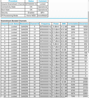

CM1200 Speed drops down to 12mbps reboot fixes it for a while
Hi all, I just bought this CM1200 and it was working fine but all of a sudden now after a while the connection drops to like 12mbps we are supposed to have gigablast (COX) service. If we reboot the ...

Your power levels are border on a bit too high.
https://kb.netgear.com/24311/Power-level-guidelines-for-a-NETGEAR-cable-modem-router?article=24311
Have the ISP check the signal and line quality UP to the modem. Be sure the ISP provisions the modem correctly.
Lots of correct and uncorrectables that should be zero.
Be sure there are no coax cable line splitters in the between the modem and ISP service box.
Be sure your using good quality RG6 coax cable up to the modem. Check for kinks and ensure fittings are correct and snug.
Be sure to power OFF the modem for 1 minute then back ON.
https://community.netgear.com/t5/Cable-Modems-Routers/General-info-and-Troubleshooting-for-Cable-Modems/m-p/1530376#M12853
https://www.duckware.com/tech/solving-intermittent-cable-modem-issues.html
Be sure your using a good quality LAN cable between the modem and router. CAT6 is recommended.
