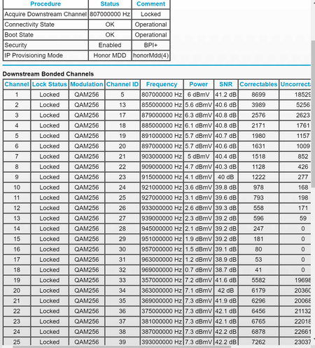

CM1200 Speed drops down to 12mbps reboot fixes it for a while
Hi all, I just bought this CM1200 and it was working fine but all of a sudden now after a while the connection drops to like 12mbps we are supposed to have gigablast (COX) service. If we reboot the ...
Kitsap
Jul 28, 2022Master
Be sure and install the Ookla native operating system applications on your various devices for testing (phones, computers, tablets). The on board router applications are historically inconsistent.
The gradual decline of throughput on a re-booted coax system is usually an indication of problems with the system ground or poorly installed/corroded end fittings.
- technicaljunkyJul 28, 2022AspirantI will have them check our lines thanks!
