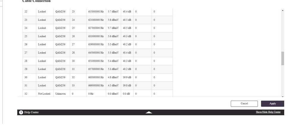

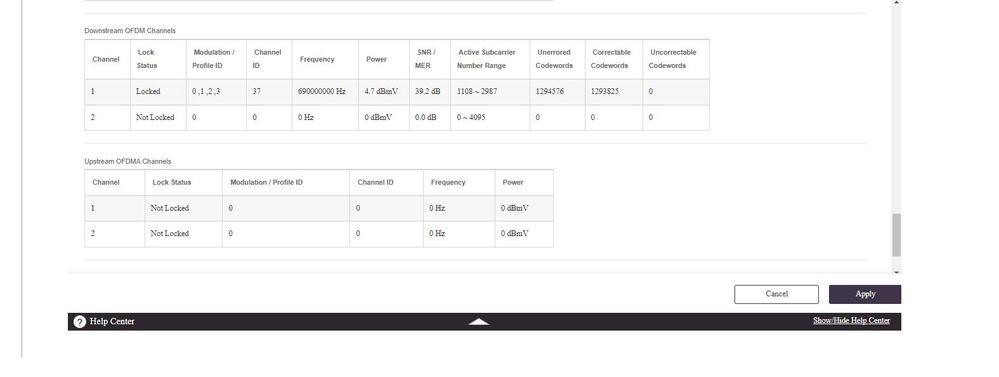

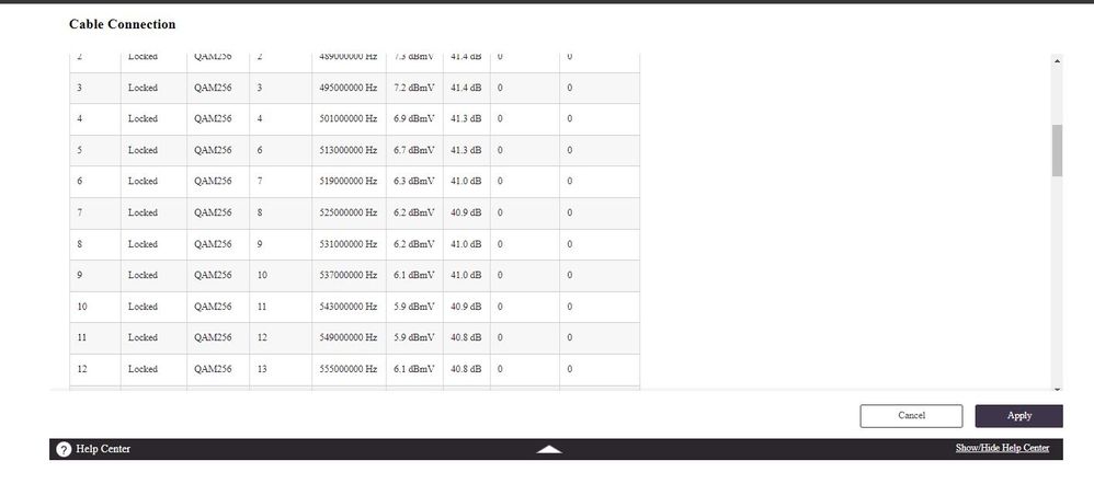

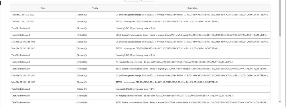

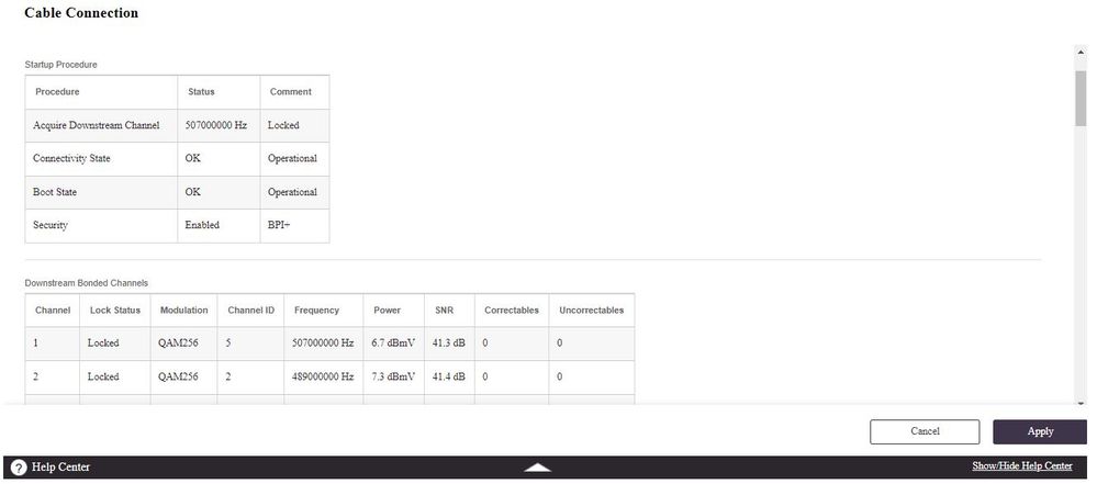

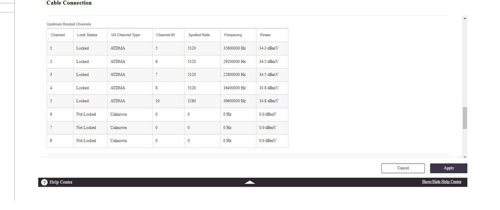

Is there anything in the logs that seem unusual?
- plemansMar 28, 2022Guru - Experienced User
tougher to read when you post them like that.
Take a screen snip of them. Its easier to read/layout.
- FURRYe38Mar 28, 2022Guru - Experienced User
The power levels on the up are a bit high.
https://kb.netgear.com/24311/Power-level-guidelines-for-a-NETGEAR-cable-modem-router?article=24311
There a some criticals seen in the event logs that the ISP should look into.
https://highspeed.tips/docsis-events/
https://www.duckware.com/tech/solving-intermittent-cable-modem-issues.html
If the ISP can't seem to get the modem online, you might need to rent one of there for short term use to see if there's connects.
Is the CM2000 new? If so, might return it and get another to see if the 2nd one works...
downstream power levels are fine.
upstream is low but that could be the OP is closer to the hub.
Plus hard to read because the uptime is only showing 54 minutes and its formatted poorly.
Use the modem for a while. Then get the logs/cable connections page. that'll show if theres issues on specific channels/logs.

I wasn't getting internet through the modem since I could not activate it, my setup only has one main coax coming from the box directly to my modem with a filter. Those logs are with the filter hooked up.
