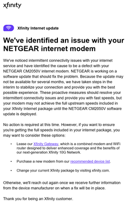

CM2050V unstable after Comcast updated firmware
Same problem here in East Bay, California, starting late September. It stops responding every 1-8 days; a physical power cycle is the only way to recover it.
Xfinity Chat "reprovisioned it", b...
- Dec 07, 2023
Comcast just pushed the old firmware (V02.01.03) to my modem, replacing the broken V09.01.01! Fingers crossed that the problem is solved.
800-COMCAST was totally useless for this problem. I was told that Xfinity never changes the firmware (apparently they don't even have the capability to do so), that I should contact Netgear for support, etc. Over 10 calls resulted in the same result. Two techs came on site, and both said that it was a modem problem, but would not/could not solve it because it was my modem. I was repeatedly told to rent an Xfinity modem.
DSL Reports was the only access to knowledgeable support. Although it was a slow interaction, they acknowledged the problem, investigated it, and said that a downgrade was forthcoming. Hopefully the company is rolling the downgrade out to everyone and not just those who find DSL Reports for help.
