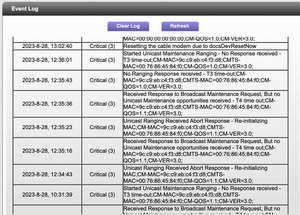

CM500 losing connection
 I've talked with my ISP multiple times and they say the issue is on my end. Everything is exactly the same in my setup as it was four or so weeks ago, before this started happening. No splitters. Jus...
Aug 28, 2023Guru - Experienced User
Any Criticals, Errors or Warnings seen in the event logs needs to be reviewed and resolved by the ISP. Indicates a signal issue on the ISP line up to the modem.

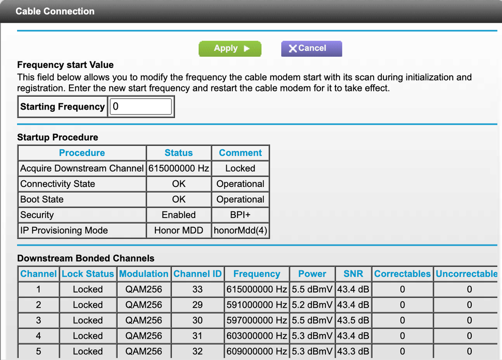

Please post a copy and paste of the modems connection status page.
https://kb.netgear.com/30007/How-do-I-obtain-the-cable-connection-information-from-a-NETGEAR-cable-modem-modem-router

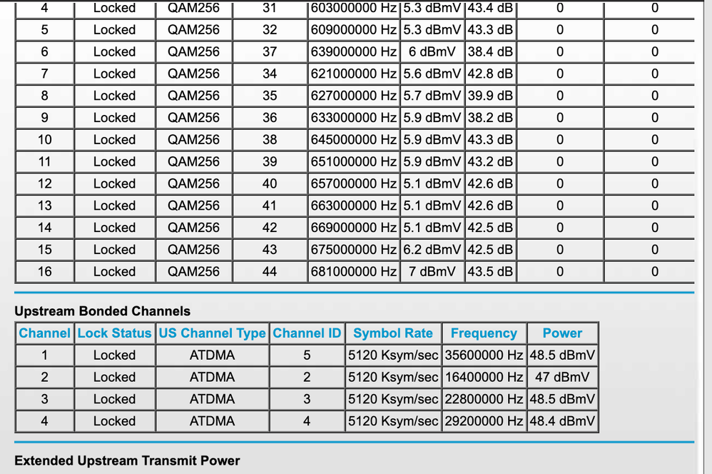

- FURRYe38Aug 28, 2023Guru - Experienced UserNo, this: https://kb.netgear.com/30007/How-do-I-obtain-the-cable-connection-information-from-a-NETGEAR-cable-modem-modem-router As seen here: - HidesomeAug 28, 2023AspirantWhoops, sorry. - plemansAug 29, 2023Guru - Experienced UserCable connection page looks good but your logs indicate a line issue. Start with removing any amplifiers, signal attenuators, or splitters from the coax.
 From there check the line for kinks, damage, moisture in the line.
 Check the connectors for improperly made ends, foil touching the copper coax line, loose connections, bad/old/cheap connectors, or corroded connections. Replace them if you do.
 If you can, simply connect the modem right where the coax comes into the home. This prevents wiring in the home from being the issue. And some ISP’s charge if the wiring issue is in the home. So this helps prevent this.If none of that helps, the isp needs to check it.
