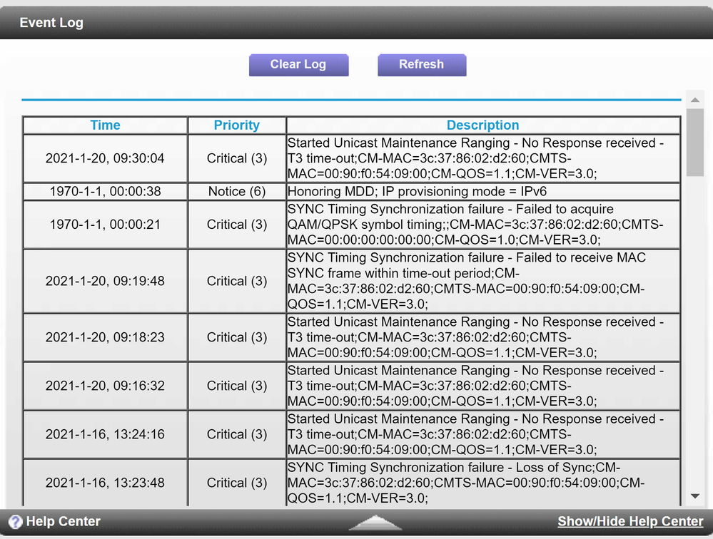

CM500 Modem is showing errors - log shows critical errors
Can someone help me explain these critical errors and time outs?
4 Replies
  • It's not letting me upload my screenshot but here's a summary of today's errors:
    TimePriorityDescription
    2021-1-20, 09:30:04Critical (3)Started Unicast Maintenance Ranging - No Response received - T3 time-out;CM-MAC=3c:37:86:02:d2:60;CMTS-MAC=00:90:f0:54:09:00;CM-QOS=1.1;CM-VER=3.0;
    1970-1-1, 00:00:38Notice (6)Honoring MDD; IP provisioning mode = IPv6
    1970-1-1, 00:00:21Critical (3)SYNC Timing Synchronization failure - Failed to acquire QAM/QPSK symbol timing;;CM-MAC=3c:37:86:02:d2:60;CMTS-MAC=00:00:00:00:00:00;CM-QOS=1.0;CM-VER=3.0;
    2021-1-20, 09:19:48Critical (3)SYNC Timing Synchronization failure - Failed to receive MAC SYNC frame within time-out period;CM-MAC=3c:37:86:02:d2:60;CMTS-MAC=00:90:f0:54:09:00;CM-QOS=1.1;CM-VER=3.0;
    2021-1-20, 09:18:23Critical (3)Started Unicast Maintenance Ranging - No Response received - T3 time-out;CM-MAC=3c:37:86:02:d2:60;CMTS-MAC=00:90:f0:54:09:00;CM-QOS=1.1;CM-VER=3.0;
    2021-1-20, 09:16:32Critical (3)Started Unicast Maintenance Ranging - No Response received - T3 time-out;CM-MAC=3c:37:86:02:d2:60;CMTS-MAC=00:90:f0:54:09:00;CM-QOS=1.1;CM-VER=3.0;

    Do you have a snip of the cable connections page ?

      • plemans's avatar
        plemans
        Your power levels are spot on. And you tend to get those errors when  you first boot up your modem.
        If you continue to get those errors repeatedly after using it for a period of time, repost the logs and the cable connections page.
        Are you having an issue?
