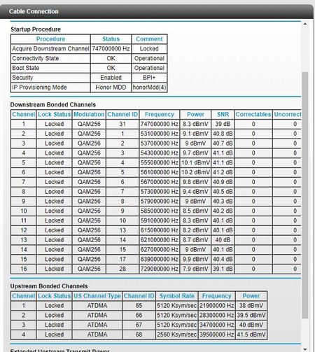

CM500 slow internet and my phone wouldn't connect
I have been having issues with my connection lately. I have rebooted both my modem and router. I have connection on my desktop, but not on my S9 phone (says connected without internet). Below is the ...

Here's an update:
1. I replaced the coax cable.
2. Rebooted modem and connected wired to a computer.Below is the new status page and event log of the modem:
- plemansMar 05, 2022Guru - Experienced User
Now you've got a ton of errors and issues with your line.
Not sure where you got that coax or how you replaced it but it was looking a lot better before you replaced it.
check your connections, the cable, splitters, etc.
- GilyemMar 05, 2022Guide
The no errors was from clearing the event log and then rebooting both modem and router. I could put back the old one and see.
