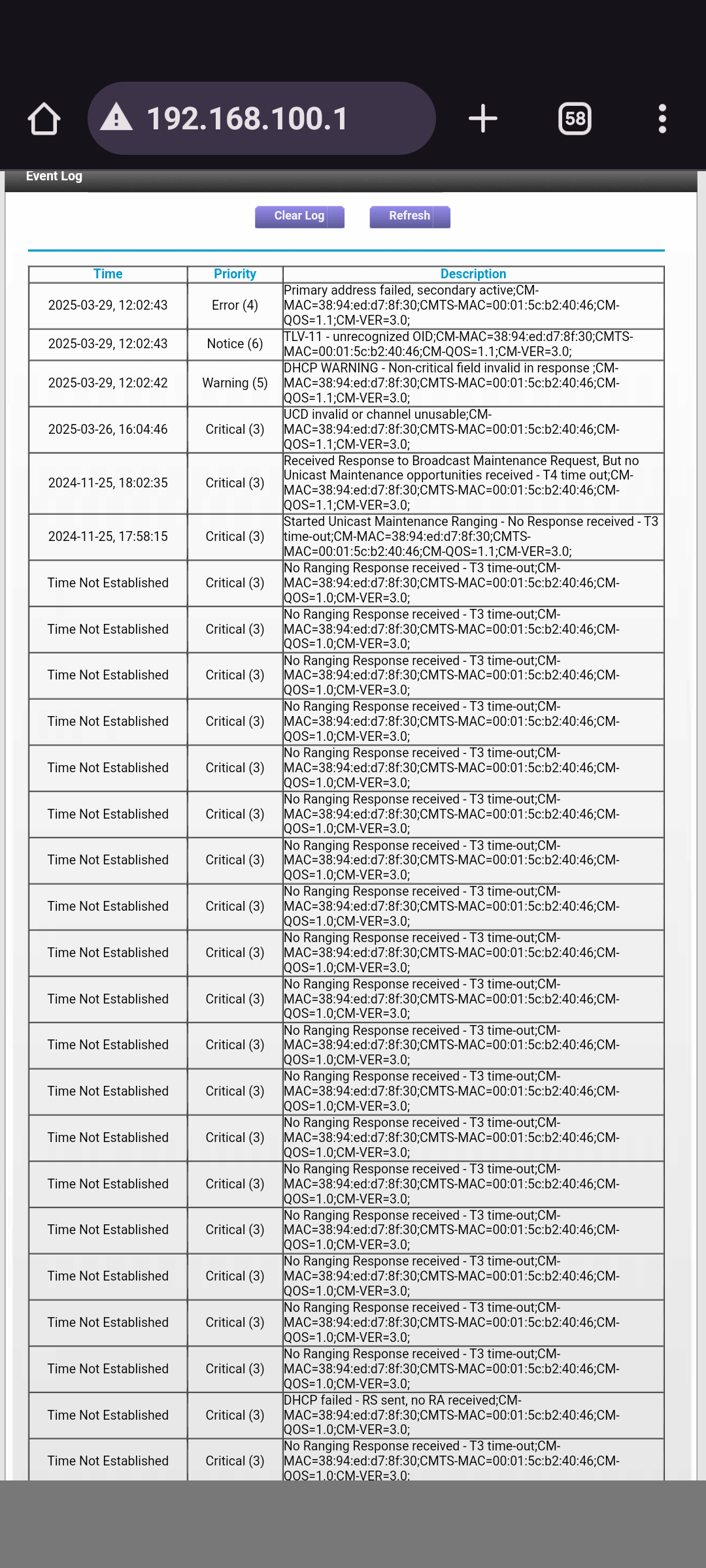

I forgot to screenshot the event log from the 1st time after i got the Modem working again (i only have the status page), but i have the most recent instance, so i will attach that. Thanks in advance.
https://imgur.com/a/LBVCyIN

    Power levels and correct and un-correctables are good.
    However lots of criticals in the event logs. Any Criticals, Errors or Warnings seen in the event logs needs to be reviewed and resolved by the ISP. Indicates a signal issue on the ISP line up to the modem.
    Have the ISP check the signal and line quality UP to the modem. Be sure the ISP provisions the modem correctly.
