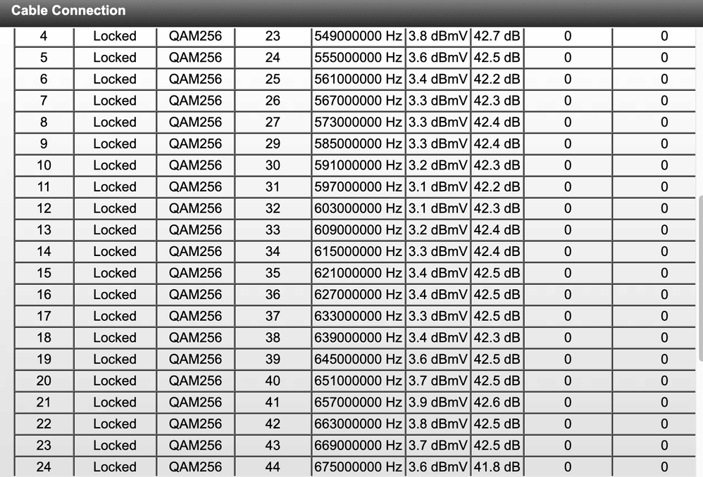

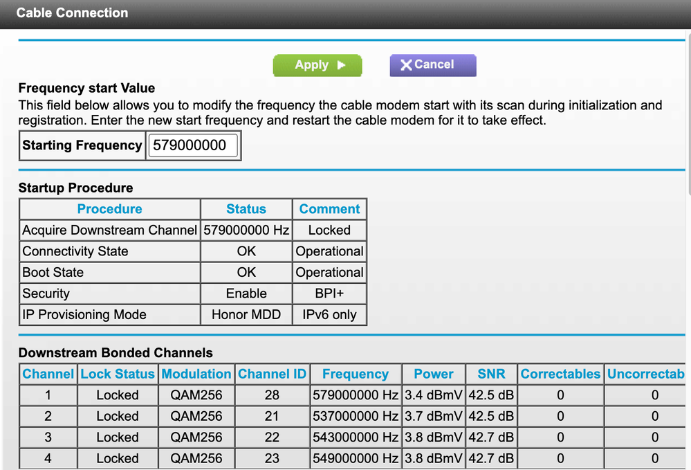

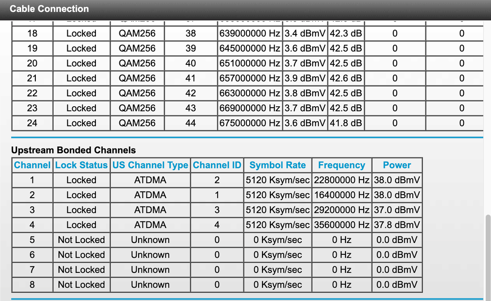

on the cable modem signal levels on the downstream channels are fine, 3.5dBmV. only 4 of 8 upstream channels are bonded. those are also at 3.5dBmV.

other thoughts? i've attached screenshots of the the cable modem diagnostics.

I'd be betting on it being that modem. Xfinity just bumped up their upload speeds but only on midsplit/highsplit devices.
The cm600 (and the cm700) won't cut it currently.

the cm600 is only a 24x8 docsis 3.0 device. While the specs say up to 1 gig, xfinity doesn't certify it to those speeds.
Its only the docsis 3.1 devices they certify up to 1 gig. Even the cm700, which is a 32x8 modem, isn't gigabit certified. It can hit 900mbps but itsn't certified for it through xifnity.
