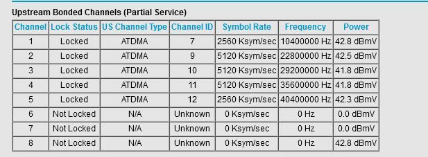

I've had the Netgear CM700 for about a year now and all of a sudden within the last 2 days the upstream light has been blinking green nonstop. My internet connection seems fine and as far as I can tell the connection doesn't seem to drop. I tried troubleshooting the device by doing a reset, factory reset, and then finally contacting Xfinity. I tried explaining to the customer support person that the modem has never done this before, but he said it was normal. Based on the various posts on this topic it sure doesn't seem normal to me.

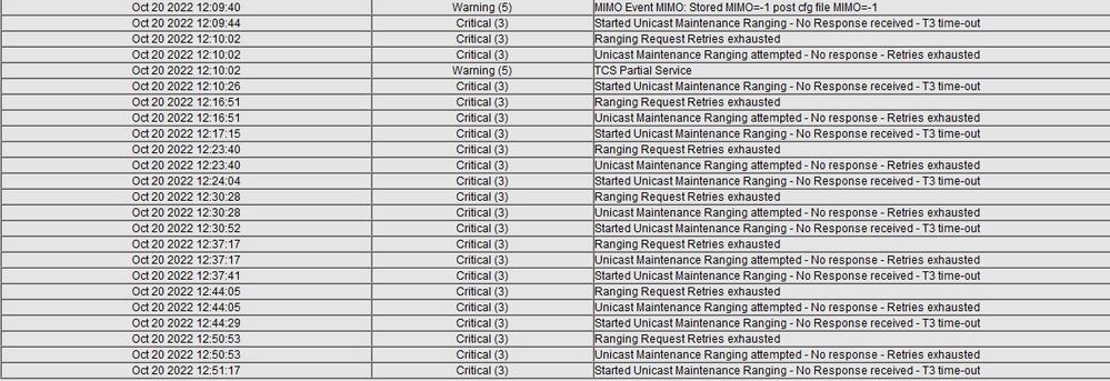

If my connection is working, should I even be concerned with this? I've attached some screenshots of the logs. Are there supposed to be unlocked channels for the Upstream?

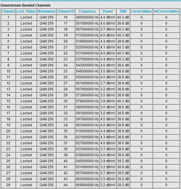

Here are the connection status and downstream screenshots from the modem. The modem is connected to my Netgear AC1900 router.
Ok, power levels look good. No correct or un-correctables.
You have lots of Criticals seen in th event logs. Something the ISP needs to review and resolve.
