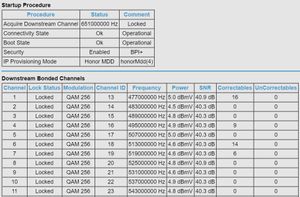

CM700 Modem
Hello I have been told by my ISP that my modem is not working properly and that it needs to be replaced. Here are the specs: Can anyone recommend anything for me to try. My ISP just increased my i...

They checked up to the modem and everything is great. With the modem, downloads are around 80's.
Sep 28, 2022Guru - Experienced User
This is with a wired PC connected to the back of the modem?
Be sure the PCs ethernet adapter is getting 1000Mpbs connection rate at the modem.
Test with Ooklas installable speed test app on the wired PC.
- xcrmomSep 28, 2022Aspirant
Coming into the home it was great speed. Once tested through the modem, the speed decreased severly.
- FURRYe38Sep 29, 2022Guru - Experienced User
Might try a different CM series modem then. CM1000, 1100, 1200 or 2000.
- KitsapSep 29, 2022Master
Your Belkin F9K1123v1 router design dates from 2014. In the technology world that is old and it will have a difficult time keeping up with modern cable internet throughput.
https://www.amazon.com/Belkin-AC1200-Wireless-Router-F9K1123/dp/B00JY4QCJQ
Recommend you also consider replacing the router.
