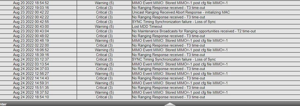

Please post a capture of the Event Log.
You have lots of Correct and Un-correctables that should be all zeros. This mostly comes from bad cabling, splitters or fittings that are not done well or snug. I would check your cabling from the ISP service box to the modem. Remove any splitters and make sure fittings are snugs and cable doesn't have any kinks or sever bends.

Here is the log file from this morning. I have since cleaned and tightened the outside butt connections but I have had one more T3 timeout since then.
- FURRYe38Aug 25, 2022Guru - Experienced User
OK, The ISP needs to resolve those Critical messages in the Event log.
