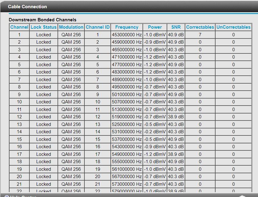

Well, it looks like it was that butt connector... or perhaps just needing to also clean and tighten the ISP side.
First, I connected the ISP cable directly to the modem outside and plugged the ethernet into a laptop. Accessed the GUI and correctables and uncorrectables were 0. So, I installed a fresh new splitter out there to the cable that runs to the network closet and tested similarly in there and success, errors still 0, so my cable is good. Phew.
So, I then reconnected CM700 modem output ethernet to the router to restore my network and everything is working... EXCEPT I can no longer log onto the modem GUI to check or monitor this going forward. On any device, wired or wifi. On any browser. I just get "can't reach page, took too long to respond" errors. Just like it had been for weeks lately until somehow miraculously I started being able to logon this morning. But that is just gone again? I really don't understand what is blocking me from reaching the modem admin GUI.

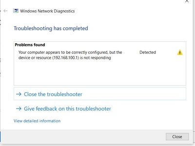

This is what windows network diagnostics says:
- FURRYe38Aug 25, 2022Guru - Experienced User
Have you factory reset the modem by pressing the reset button for 10 seconds then release with out the ISP coax cable connected the modem and 1 wired PC connected to the back of the modem?

No, I am afraid that will cause me to have to call Comcast to redo the provisioning. Don't want to do that. But LOL it just started responding again, who knows why? All errors are zero except channel 1 correctables which is 7. I am ready to call this one solved.

Make sure you are not using 192.168.100.xxx as the base IP address for your router. Suggest 192.168.1.1 or 10.0.0.1.

To answer the other poster, the modem IP is completely out of my router's subnet.
