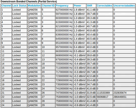

Model: Netgear C7500-100NAS Firmware version V1.01.32 Hello all, I am having an issue with bad Internet connection from Comcast and they suggested that it was my brand new C7500's fault which d...

I see a crazy amount of uncorrectables on channel 21 and 22 which typically indicates a connection issue with the ISP do you have any t3 or t4 timeouts showing up in the logs of the modem?

Feb 01, 2018Yes, I am getting some T3 timeout errors:
MDD message timeout;CM-MAC=08:02:8e:**:**:**;CMTS-MAC=00:01:5c:**:**:**;CM-QOS=1.1;CM-VER=3.0;
No Ranging Response received - T3 time-out;CM-MAC=08:02:8e:**:**:**;CMTS-MAC=00:01:5c:**:**:**;CM-QOS=1.0;CM-VER=3.0;
- DarrenMFeb 02, 2018Sr. NETGEAR Moderator
I suggest contacting your ISP and have them send a Tech to check your home connections and the connections in the area.

Looks like it was a Comcast problem after all. After getting a tech out they finally agreed that the problem was on their end. Thank you for your help!
