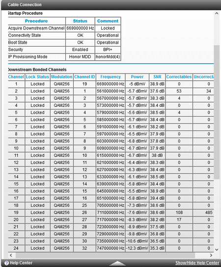

constant upload speed dips and upload packet loss with my ac1900 c7000v2
as the title says I'm having constant drops making streaming hard to do I'm wired never wireless any help would be appreciated firmware version is 1.03.01 and here's the cable connection informatio...
Aug 16, 2022Guru - Experienced User
Have the ISP check the signal and line quality UP to the modem. Be sure the ISP provisions the modem correctly.
Be sure there are no coax cable line splitters in the between the modem and ISP service box. Ensure coax jack fittings are snug. These can cause some corrrect and un-correctables that you and the ISP needs to look into.
Be sure your using good quality RG6 coax cable up to the modem.
Be sure to power OFF the modem for 1 minute then back ON.

Your power levels are a bit too low:
https://kb.netgear.com/24311/Power-level-guidelines-for-a-NETGEAR-cable-modem-router?article=24311

FURRYe38idk if this helps at all but here the logs saying critical error multiple times today (idk what to cover and what not so i covered what i felt needed to be)
- FURRYe38Aug 17, 2022Guru - Experienced User
Ya you have some errors and criticals that the ISP needs to look into.
