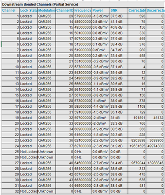

My internet works but the downstream keeps blinking and I am getting packet loss whenever I watch a stream or play games. It works with 0 packet loss for awhile then sometimes it goes to 20% packet loss. I have provided some downstream info below.

https://kb.netgear.com/30008/How-do-I-view-or-clear-the-event-logs-on-my-NETGEAR-cable-modem-or-modem-routerYou have lots of correctables and un-correctables that should be zero's.

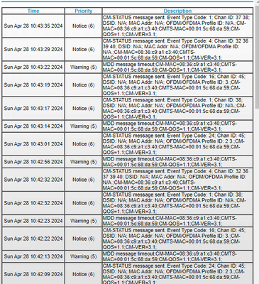

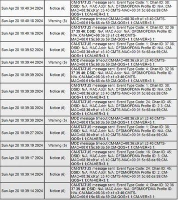

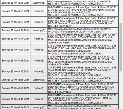

Hi FurrYe38,
I appreciate the time you are spending to assist with my issue. Here are the event logs below.- FURRYe38Guru - Experienced User
Any Criticals, Errors or Warnings seen in the event logs needs to be reviewed and resolved by the ISP. Indicates a signal issue on the ISP line up to the modem.
