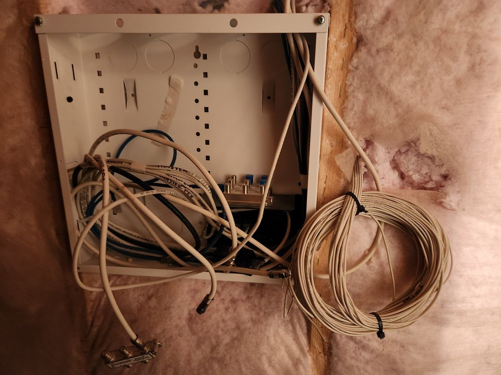

Seeing some correctables and un-correctables that should be mostly zeros. Channel 1 seems to have the most. Not terrible though.
Power levels are good.
Any Criticals, Errors or Warnings seen in the event logs needs to be reviewed and resolved by the ISP. Indicates a signal issue on the ISP line up to the modem.
Have the ISP check the signal and line quality UP to the modem. Be sure the ISP provisions the modem correctly.
Be sure there are no coax cable line splitters in the between the modem and ISP service box.
Be sure your using good quality RG6 coax cable up to the modem.
Start with removing any amplifiers, signal attenuators, or splitters from the coax.
From there check the line for kinks, damage, moisture in the line.
Check the connectors for improperly made ends, foil touching the copper coax line, loose connections, bad/old/cheap connectors, or corroded connections. Replace them if you do.
Be sure to power OFF the modem for 1 minute then back ON.

I found this rat's nest of wiring in my basement. There could be something going on here for sure. The previous owners were a lot of DIY'ers/contractors so this might have been them.

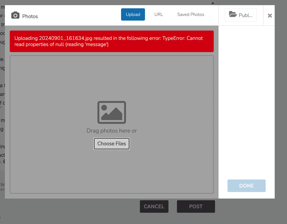

Rat's nest of wiring.Here's a perfect example of a failed upload to a site when I'm on wifi as seen here for this post. Plug in ethernet and it works.Great Example of an error I get on wifi uploading
