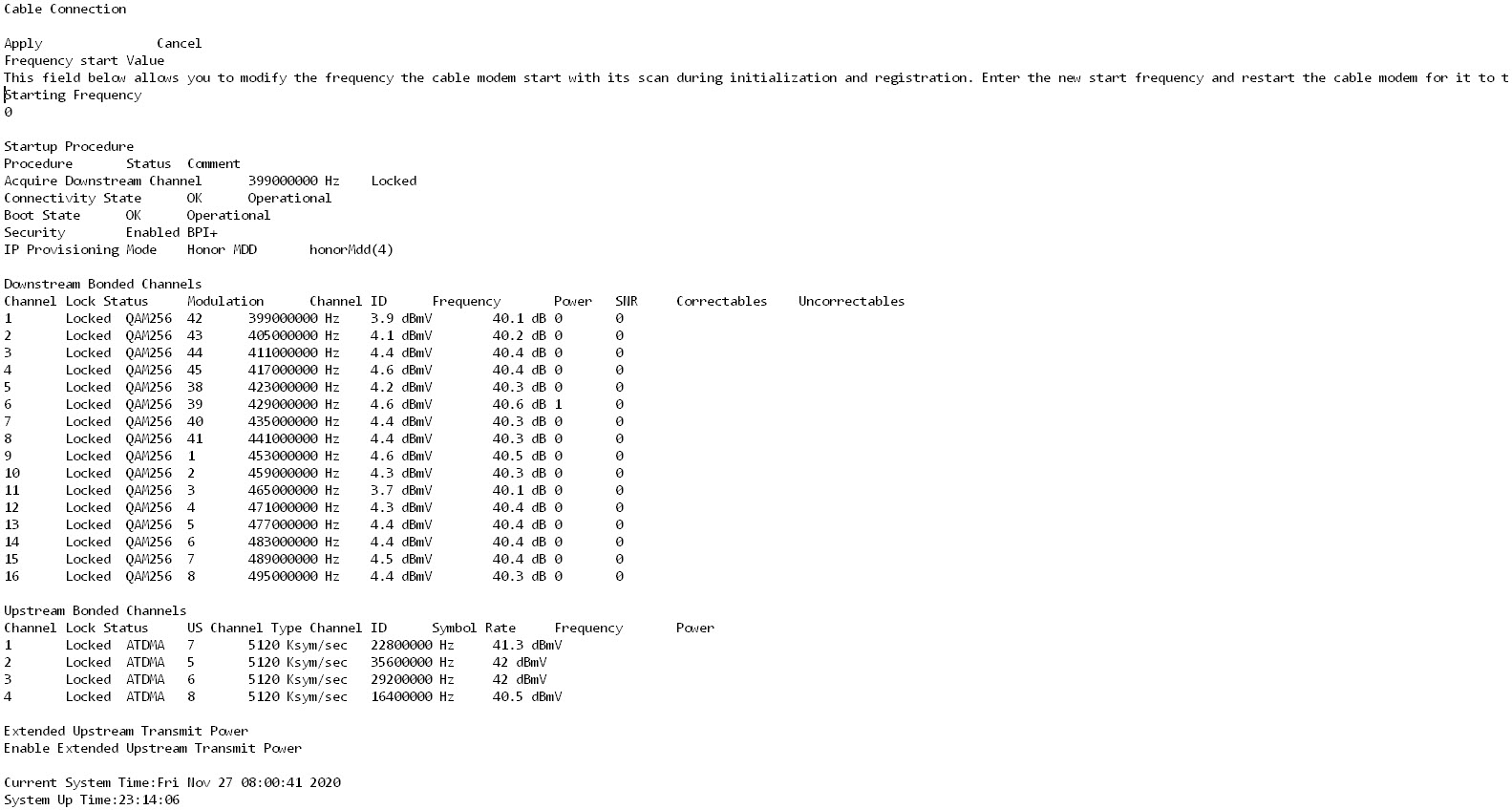

do you have a screen snip of the cable connections page and the logs?
Those help us check the connection.
If you have any splitters, amplifiers, or attenuators in the coax line, I'd remove them. Check the line for kinks, damage, bad/cheap/loose connectors.

The download signal for all 16 channels range from 4.3 dbmv to 5.0, so that looks pretty good I think.
The upload signal for all 4 channels range from 40.5 dbmv to 42.5, again that looks pretty good.
My speed ranges from 1.2 Mbps to 23.5 to (at times) with 168.3 rarely (download). Upload ranges from 0 to 1.2 Mbps. All with a service of "up to" 300 Mbps; so something is drastically wrong here. :)
I'm having a Comcast tech come out on Saturday to take a look at, but if I'm getting those signal levels it sounds like the issue is not with the modem, but let me know your thoughts. I'll post what I find out. Thanks again.

Cable Connects file attached.
(more to come, since I can only attach one file at a time)
