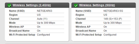

I have register my cable modem with xfinity and i do have internet access when i connect to the 5g Wifi I get at most 54Mbps but when connected via ethernet to the netgear box i get the 75+ Mbps ...

Have you tried to change the wireless channel Also I have seen if you change the modem to a lower speed it can fix some wifi speed issues.

on 2.4 GHZ i have tested 3 6 and 11
and on 5Ghz i have used the empty onei am starting to think that the box is busted
still no luck
